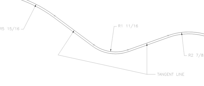

Just for some general info here on all my mid and small size guitars the waist is a 1 11/16" radius attached to the transvers arc of the the upper and or lower bout with a tangent line. The example below is my SJ
MichaelP38985.6993981482
